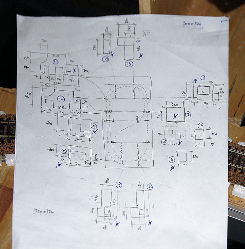

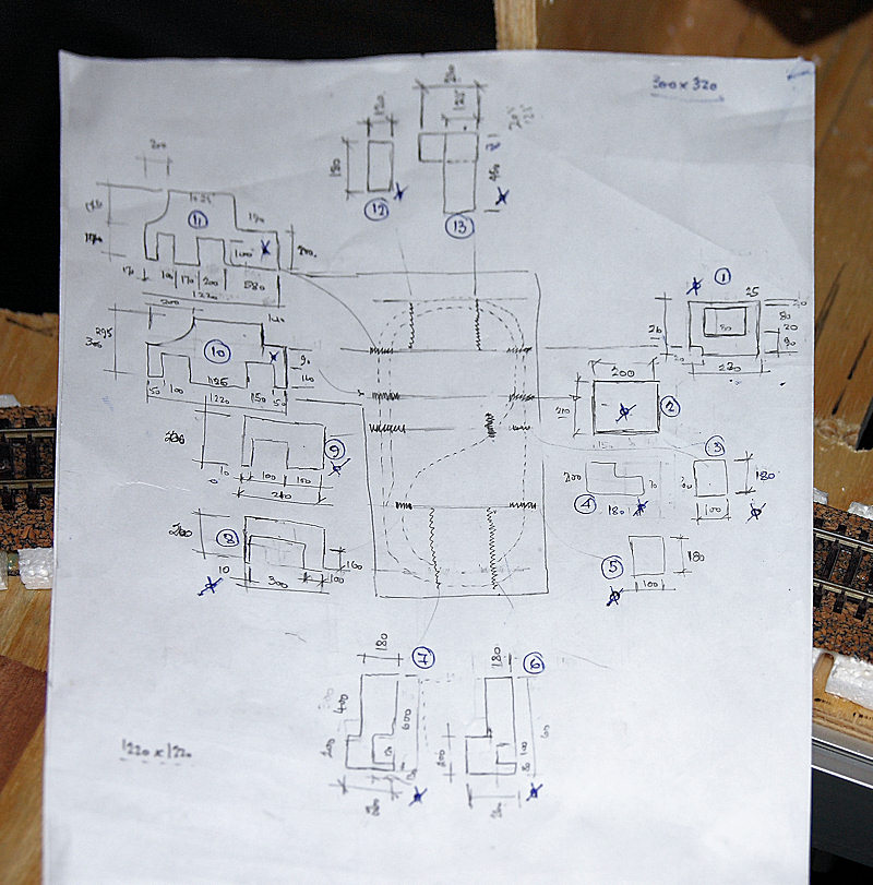

The human eyeball, and a tape measure is used and the positions for the risers worked out. This is all recorded on a working plan, and the risers are then cut out and marked to correspond to the plan.
Photo 1 - The working plan marked up. Simple!

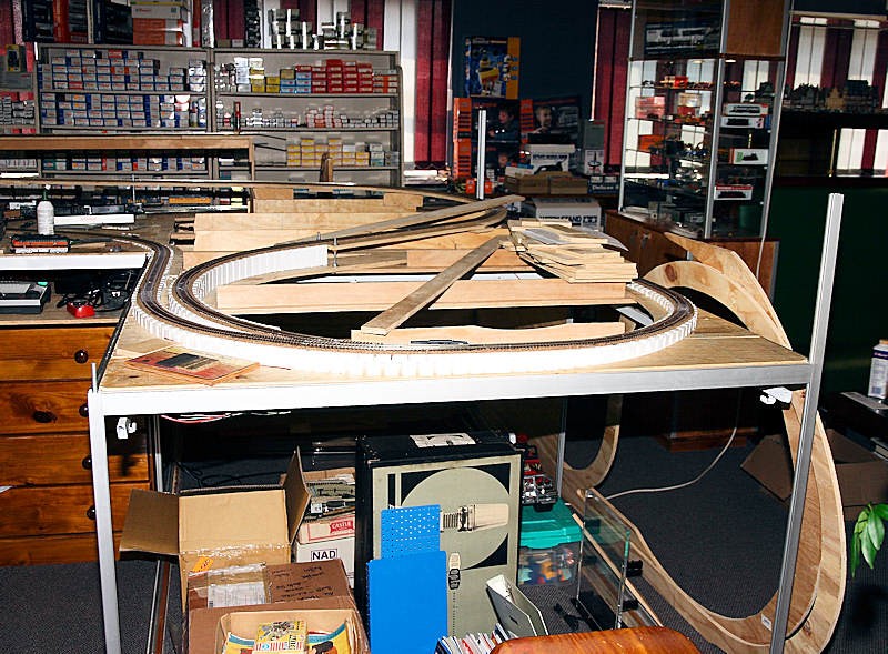

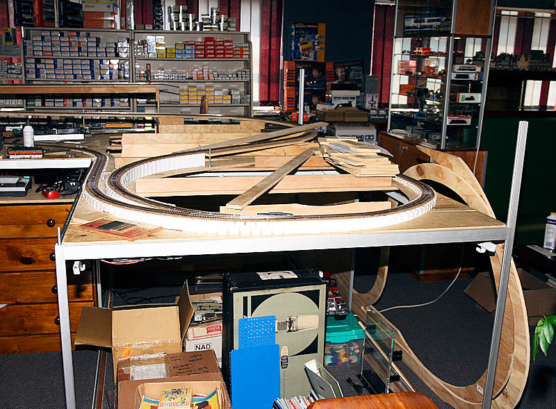

Photo 2 - The work area with the cut risers stacked on the right of the table.

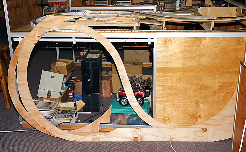

Photo 3 - The cut out rail bed awaiting installation.
