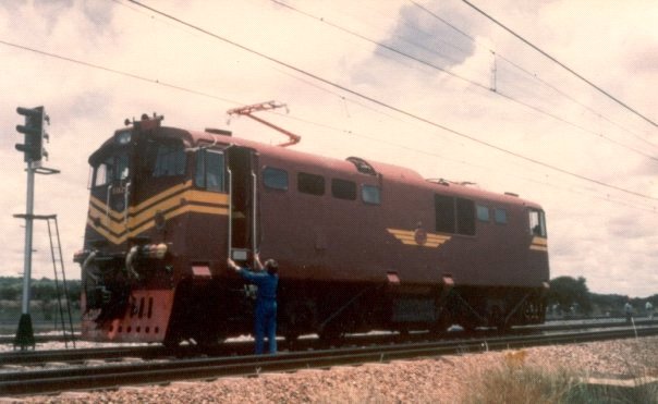

While talking about 6E1's, There is one of those "where were you when..." mails doing the rounds with this pic in it. Based on the newer style panto, old livery and number plate on the door, is there any way to nail down the era she is from?

This loco is 6E1 1525. She was modified and this test carried out in Rosslyn in 1980. The loco was tested up to 245 km/h. It was the forerunner of the Metro Blitz that could run safely at 140km/h.The pantograph in picture was designed for High Speed

Does that mean she may still be around? didnt the Metroblitz locos get converted to another class?

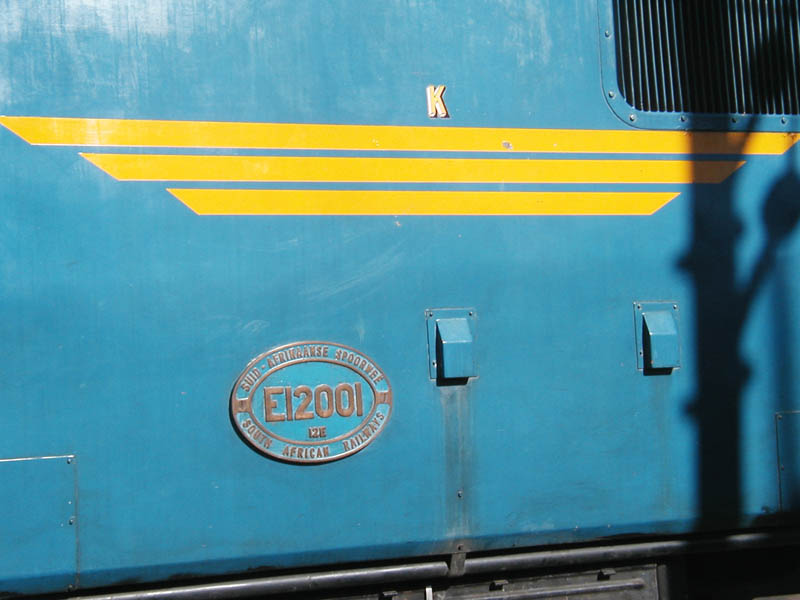

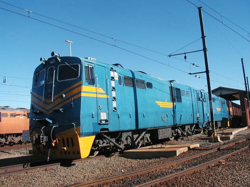

The Metro Blitz Loco's were 6E'1s converted to 12E's numbered 1 to 5. Its possible that 1525 could have been one of those. I enclose two photos I took in June 2003
on my visit to Beaconsfield Kimberely. They were used to pull the Blue train from Kimbereley to PTA. Now taken over by the 14E's which run the full distance from Cape Town to Pretoria

Nice one Stefan, but I must point out that E1525 did not attain 245kph on this trial, but on a previous trial when fitted with Scheffel bogies. She only(!) made 200 on this trial (an extremely creditable 125mph in UK money!)Stefan Andrzejewski wrote:This loco is 6E1 1525. She was modified and this test carried out in Rosslyn in 1980. The loco was tested up to 245 km/h. It was the forerunner of the Metro Blitz that could run safely at 140km/h.The pantograph in picture was designed for High Speed
Here's a bit more info
http://www.traintesting.com/SAR.htm

Stefan, 12E's was built from scratch at U&W in Nigel on the basis of the 6E's but with a different gear ratio and one driving cabin.
From UCW website:
TECHNICAL DATA SUMMARY
Modified 6E1. 3kV DC; 1067mm Gauge; Bo-Bo; Wheel diameter 1220mm; Speed 150km/h max.; Total mass 83.6t (20.9t/axle); 240kN TE (starting), 149kN TE (Continuous); 2492kW (One hr power rating), 2252kW (Continuous); Gear Ratio 23/66; Single cab & Conductors room; Intercity passenger service. "Metroblitz" (Jhb - Pretoria).
YEAR OF MANUFACTURE : 1985
TOTAL PRODUCED : 6
CUSTOMER : Spoornet (South Africa)
From UCW website:
TOTAL PRODUCED : 6
