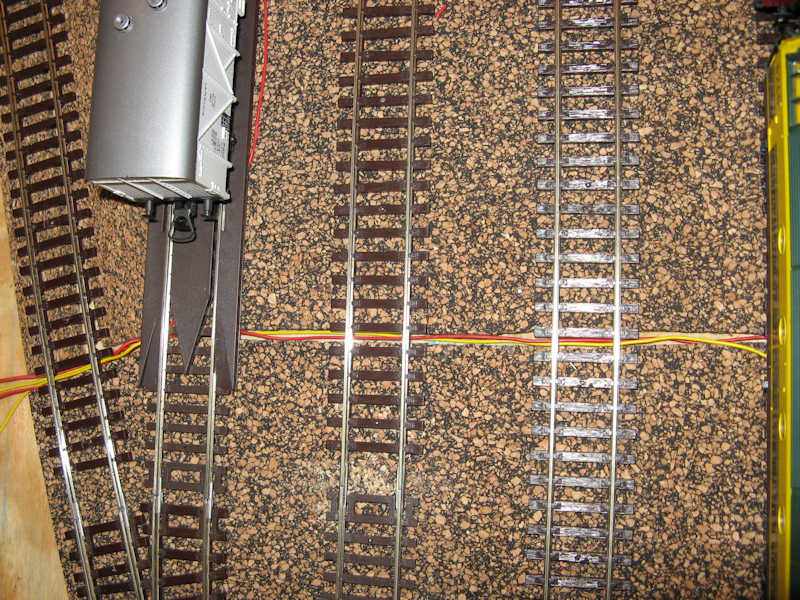

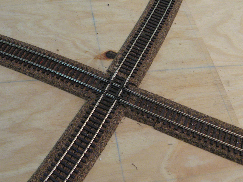

A unusual piece of track for a European layout - a crossover. But, it is hidden!<br /><br />The frogs on the crossover are plastic and were filed down to ensure smooth running of rolling stock with different wheel diameters and thicknesses (as per different manufacturers etc.).

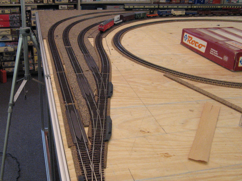

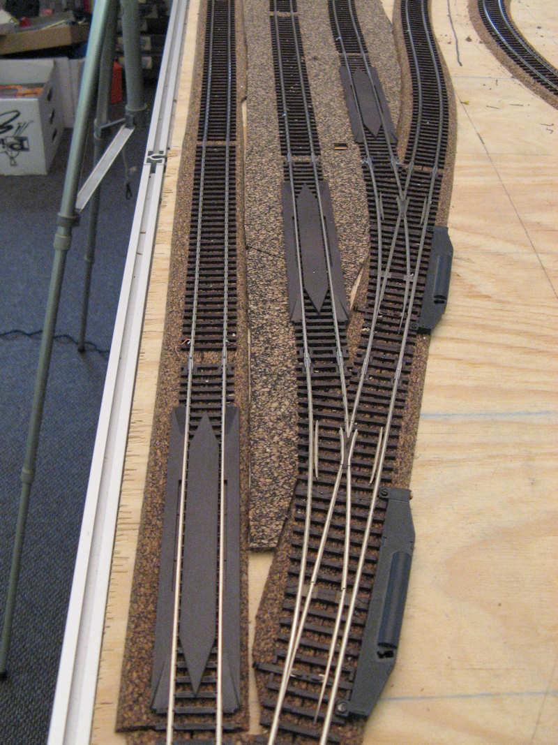

A general view of the points into the yard, Note the re-railers.
Close up of the re-railers. Since the track work is &quot;hidden&quot; reliability is required, so after every trailing point where the track work is covered, re-railers have been placed.
Close up of the re-railers. Since the track work is "hidden" reliability is required, so after every trailing point where the track work is covered, re-railers have been placed.

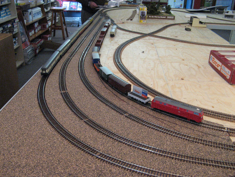

The curves in the storage yard. These were laid by eye to give as gentle  a running curvature as possible.

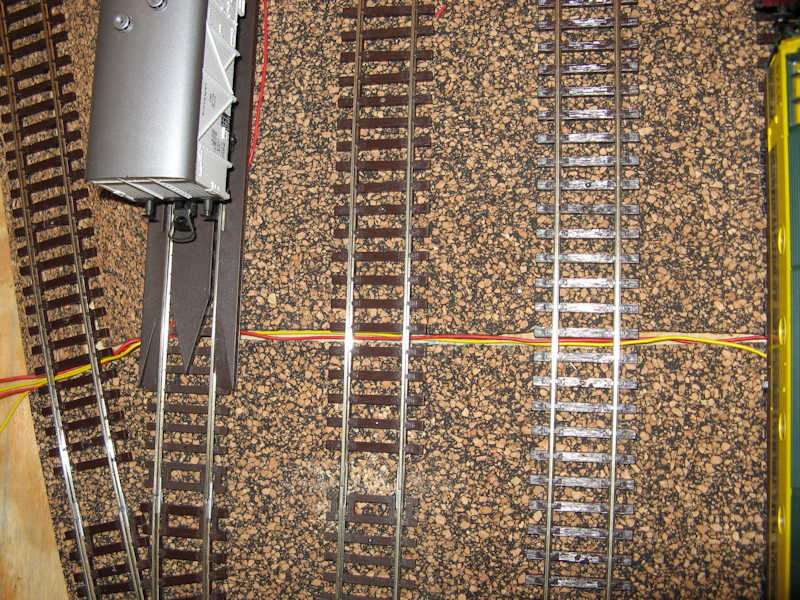

Temporary power wires used for testing.

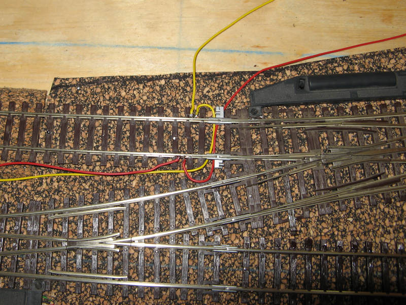

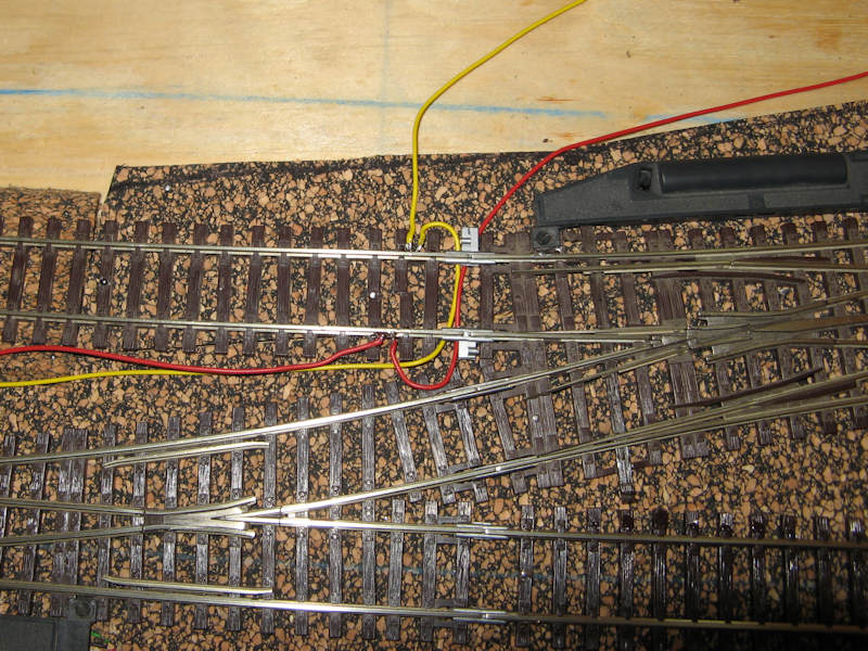

This photo shows temporary point wiring used for testing functionality.

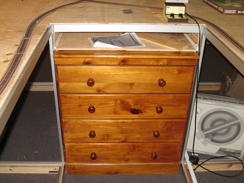

The center of the inverted &quot;U&quot; holds a chest of drawers - both for storage and support.
The center of the inverted "U" holds a chest of drawers - both for storage and support.

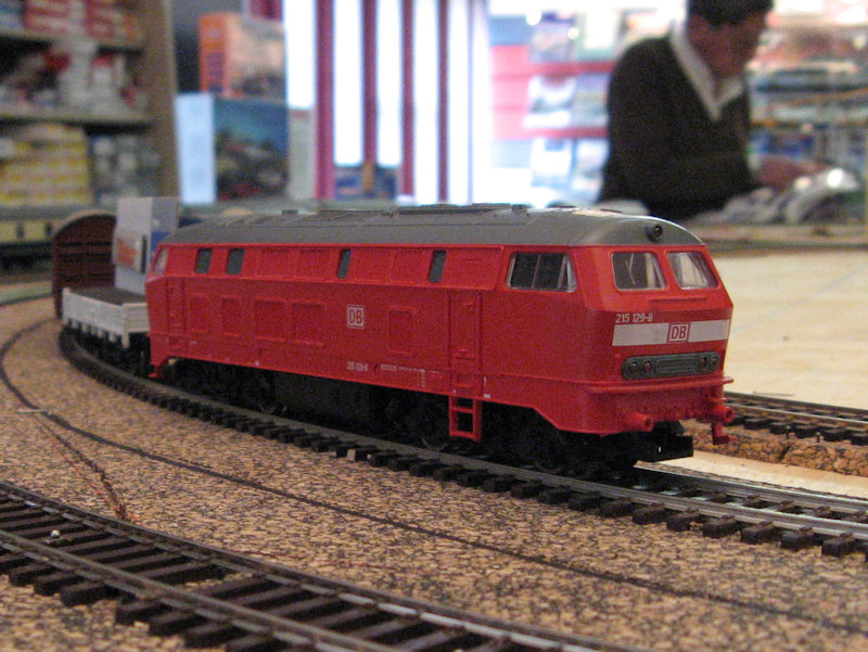

The trusty test train - a different engine today.
