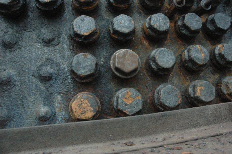

19D number 2650 has had some lagging removed to expose leaking stay caps, which have since been replaced.
Cap Park update 21 Oct 2012 009.jpg (88.2 KiB) Viewed 12767 times
Closer...
Closer...
Cap Park update 21 Oct 2012 011.jpg (85.14 KiB) Viewed 12767 times

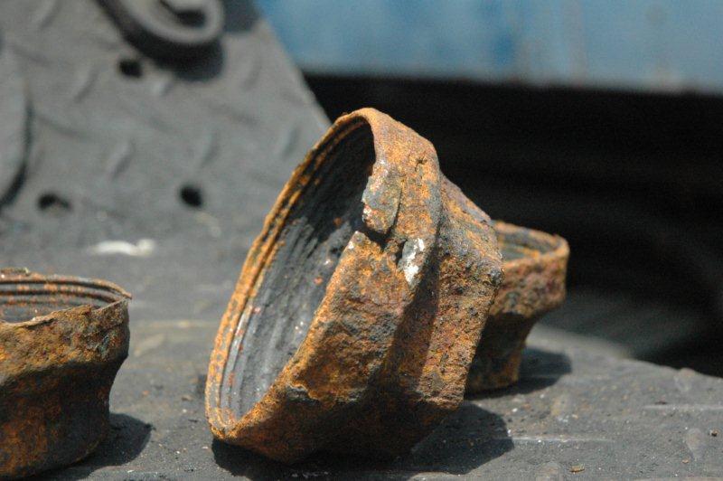

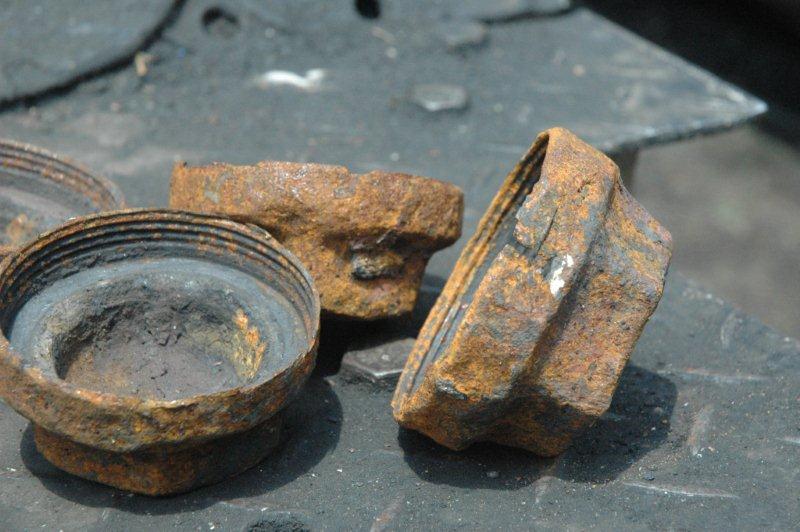

Close up of the leaking flexible stay caps. One can see how worn they are.
Cap Park update 21 Oct 2012 012.jpg (70.94 KiB) Viewed 12767 times

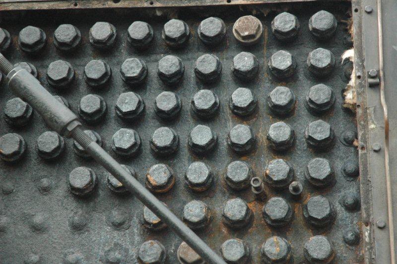

Ditto
Ditto
Cap Park update 21 Oct 2012 013.jpg (58.93 KiB) Viewed 12767 times

I hope the stay cap seats are still in good shape?
Replacing just the cap can sometimes be a temporary solution to a longer term problem...

Having change only the caps on 2 of our locos at Usr in the past,it was found to be a wasted exercise as the stay seat in the boiler itself is generally in the same condition as the caps you replace.On both occasions the locos ran for another few months untill the seats began to fail with the new caps on.All the working and tightening of new caps on the old seats caused more problems.All I can say is good luck hopefully you guys have more luck than us guys at Usr but looking at the pictures on the post, you heading down the full flexible side stay replacement road.What do the flexible crown stay and ridgid cross stays look like?

Hi john,thanks,the problem with the seat thats threaded into the outer boiler plate, is that where the thread for the cap steps down to the taper thread of the seat its counterbored for the rocker washer under the stay and that counterbore plus the wastage from the outside and years of rusting, it gets to thin and cracks(leak).Even with a new cap the seat will almost always leak later on.From looking at the SAR drawings and the home work we ve done its a design flaw from new!Most locos in SAR service got overhauled boiler every few years!All of us working locos around the country have never had this kind of overhaul in 30 + years! We have just finished a full flexible stay replacement our 19d 2685 which has taken a full year including other major jobs(R600 000 later)Hopefully it will steam again next month all going well!As I said before Good luck.

I quite agree with comments made here. The old boiler inspector, now deceased, Johan Smit, said to us once, that when the flexible stays start to go, they follow each other. I was intending to ask you Andersons, what costs are to make such flexible stays as we have a lot of the caps.

Nathan, if and when you guys start a full flexible stay replacement project, I dont think it would be advisable to use the old SAR caps. We have found that the machined caps which as Simon mentioned have been redesigned with a bigger wall thickness. In addtion, the new steel stands up to corrosion much better than the old cast caps.
