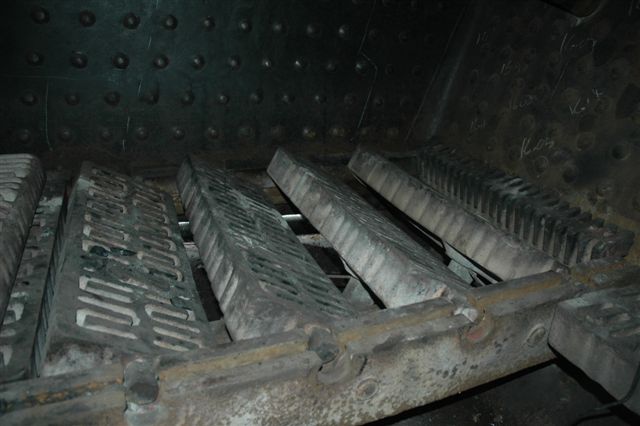

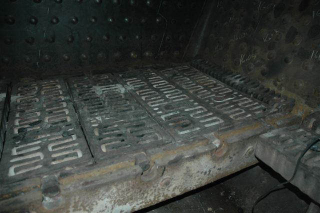

Viewed from inside the 15F firebox, the confusing mess of loose firegrates await fitting, but first the various open spaces in the ashpan must be closed to avoide live coals falling out.
15F3117progressjan2008locos 029.jpg (49.63 KiB) Viewed 1213 times

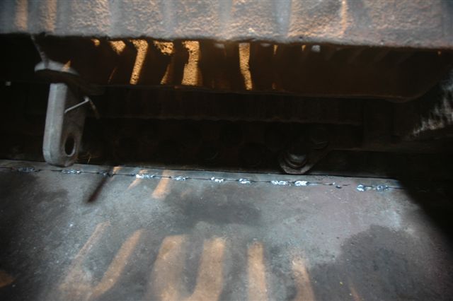

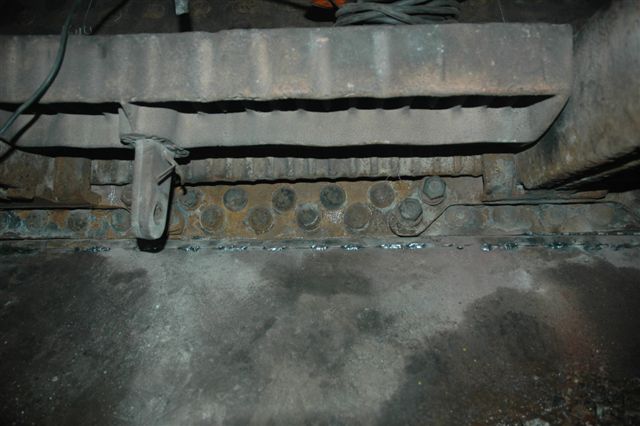

The metal strip welded in place inside the firebox onto the ashpan, will ensure there is no  chance of a live coal exiting and causing a fire risk. This view is taken from under the grates, looking towards the tubeplate, whilst standing in the ashpan!
15F3117progressjan2008locos 045.jpg (42.44 KiB) Viewed 1213 times

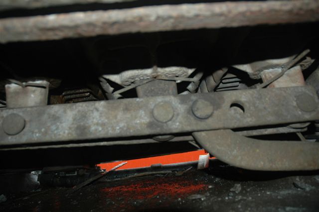

How the firebars are coupled up. Viewed from the aspan end.
15F3117progressjan2008locos 047.jpg (46.4 KiB) Viewed 1213 times

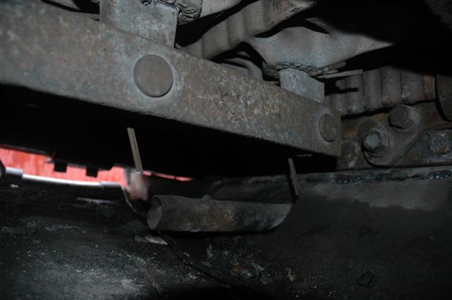

The metal strip to prevent any live coals from accidently exiting the firebox, has been welded in place by John Dadford. The ashpan has been checked for such possible danger areas and closed up. Viewed here in 15F 3117's firebox looking up from under the grates.
15F3117progressjan2008locos 050.jpg (52.34 KiB) Viewed 1212 times

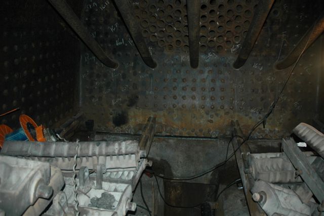

Firebars coupled up for the first time and ready for a test. This 15F 3117 is a hand shaker locomotive and thus various sections of the grates can be shaken to clear the fire of clinkers. Most locomotives are steam shakers.
15F3117progressjan2008locos 051.jpg (42.23 KiB) Viewed 1212 times
Firegrates coupled up on the left front section, ready for the first shake.
15F3117progressjan2008locos 052.jpg (50.24 KiB) Viewed 1212 times
Success, a beautiful gap revealed, as the firebars open correctly. Soon live coals will be shaken up on this bed.
15F3117progressjan2008locos 053.jpg (48.95 KiB) Viewed 1211 times

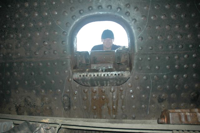

"I CANT BELIEVE IT" says Les, as he witnesses the first grate shake on 3117.
15F3117progressjan2008locos 055.jpg (49.01 KiB) Viewed 1211 times
