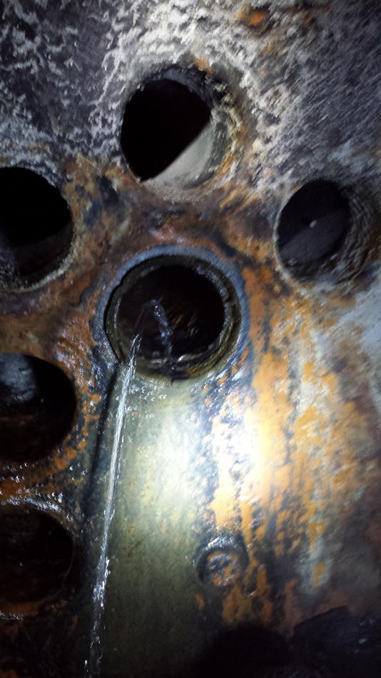

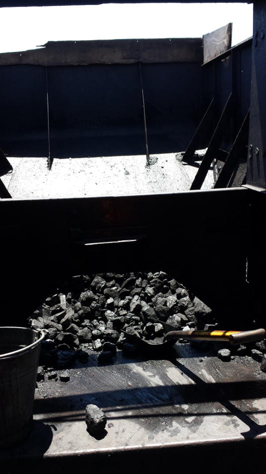

Peter wrote:includes the remaining coal in 2650 before recoaling Thursday 4th........ and the leaking tube which caused the excessive coal consumption.
FOTR early December 2014: a leaky tube...
Photos by Peter Odell.

The water coming out of that tube appears very clear, What is used in the way of Boiler treatment?

Hi Simon,Simon Walker wrote:The water coming out of that tube appears very clear, What is used in the way of Boiler treatment?
Water treatment is added to the water in the tender usually on a Thursday, prior to light-up! I'm not sure exactly what water treatment is added but it gets done by Spikkels.
In my opinion, if I may say, I think the life-cycle of the tubes have come to an end, as most of the tubes have been in the boiler for more than 10 years. Of late, we have been replacing them, small and a large tube, in batches of 3's and 4's, but the remaining tubes will be replaced shortly, as 2650's boiler certificate expires sometime early next year!
Regards Gabor
