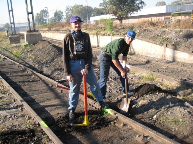

- Adrian (left) and Frank dig out a sleeper that has been marked with yellow paint
- IMG_0637s.JPG (117.44 KiB) Viewed 4175 times

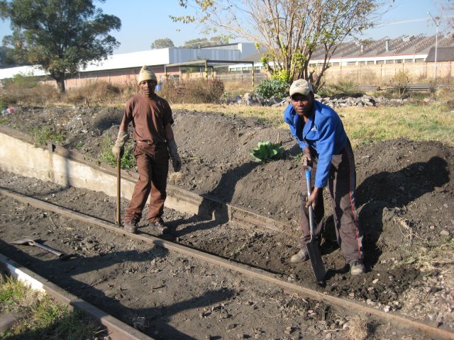

- Two casual labourers continue to dig away the earth at the side of the track
- IMG_0638s.JPG (119.82 KiB) Viewed 4173 times

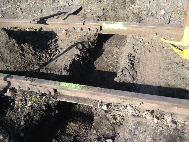

- The old sleeper has now been dug out and is ready for a new one to be inserted
- IMG_0642s.JPG (110.54 KiB) Viewed 4174 times

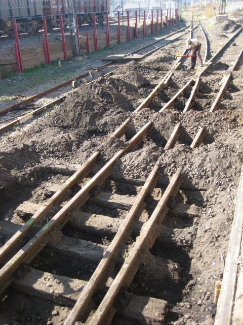

Our main worry was the set of points in front of the goods shed, but having dug it out it looks as if there are fewer rotten sleepers than we thought - we'll probably replace four or five.
One of the reasons for the rot is that water stands in this area after rain. We're going to try to improve the drainage while we're working on it.

Would it not be better if the existing siding in its entirety be re-ballasted to raise the track level by at least a sleeper thickness in height?
Looking at the pictures already submitted, it looks that there is very little ballast and especially under the points concerned, the track seems to be resting more on hard earth than ballast!

Thanks, Gabor. What you've suggested is in fact the long-term plan. We want to raise that entire platform loop and pack new ballast under it. However we'll be doing things in stages, due to time, personnel and money constraints. First step is to replace the rotten sleepers and improve drainage locally (TFR have already dug a drainage ditch outside our fence which we hope to tap into). When we put the new sleepers in we'll use clean ballast - you're correct in your observation that they are mainly lying on dirt now. Then at a subsequent stage we'll tackle the larger task of raising the entire trackbed.
