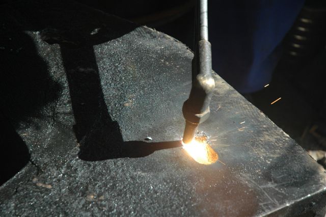

The contrast of light and dark, as the acetylene cutter enlarges a hole in the firebox door frame

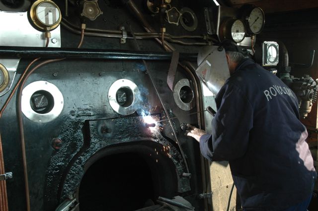

The firebox door frame required a number of welds to build up the fastening studs, after years of use and corrosion. Oom John at work

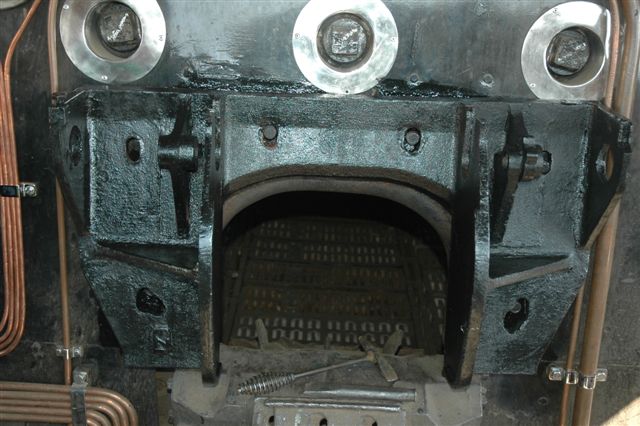

First fitting of the door frame on the 15F 3117 firebox. It needed some work still to get the bolt holes to line up properly, but another step nearer to completion

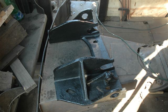

Cleaned and painted and waiting to be fitted, the firebox door frame of 3117 lies on the cab floor prior to fitting

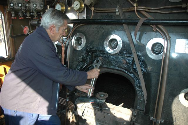

Oom John is cleaning the threads on the studs, prior to the firebox door frame being refitted to 15F 3117. As far as restoration goes, there is at present almost no work left on her to do. First trial light upwill be at end August.
