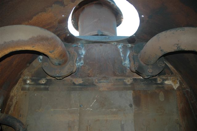

The empty smokebox chamber of 3117. There were a number of places where gaps had to be closed up by welding metal strips in place to prevent sparks from being emitted, and thus preventing line side fires. To affect the repair, the complete petticoat and chimney had to be removed. Work was also carried out on the left side branch steam pipe
capital park 15F3117aug08 011.jpg (43.01 KiB) Viewed 1262 times

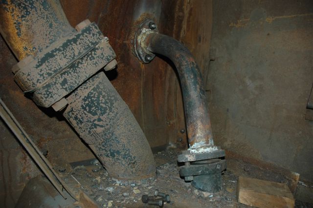

The branch steam pipe on the driver's side in the smokebox of 15F 3117. There was damage to the flange, which was cracked, and a small pin hole in the pipe itself
capital park 15F3117aug08 012.jpg (55.68 KiB) Viewed 1262 times

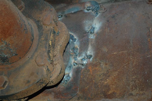

Close up of some of the welding in the smokebox. This was done to close up spark emitting gaps
capital park 15F3117aug08 013.jpg (55.37 KiB) Viewed 1262 times

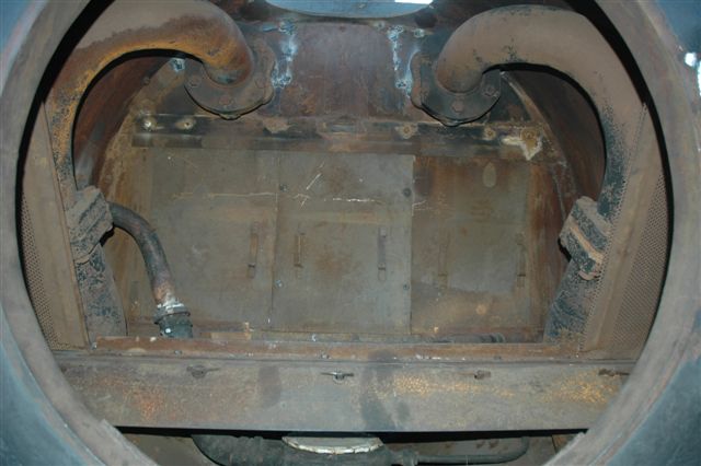

A better view of the smokebox chamber framed by the door space. Petticoat and chimney have been removed to effect welding repairs to close spark emitting gaps
capital park 15F3117aug08 016.jpg (50 KiB) Viewed 1262 times
