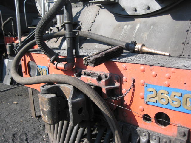

Washout hose and nozzle

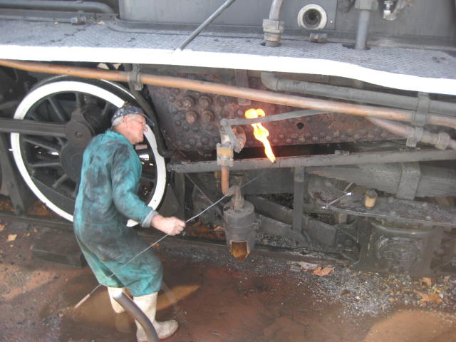

The old fashioned way - a flame is used for illumination inside the boiler

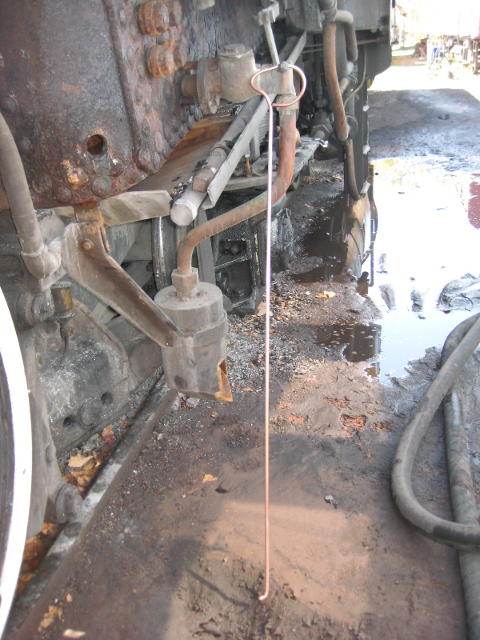

Pricker for scratching around in the boiler

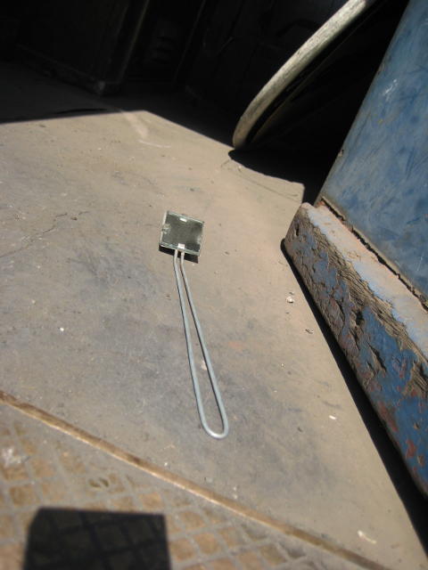

Mirror
Mirror

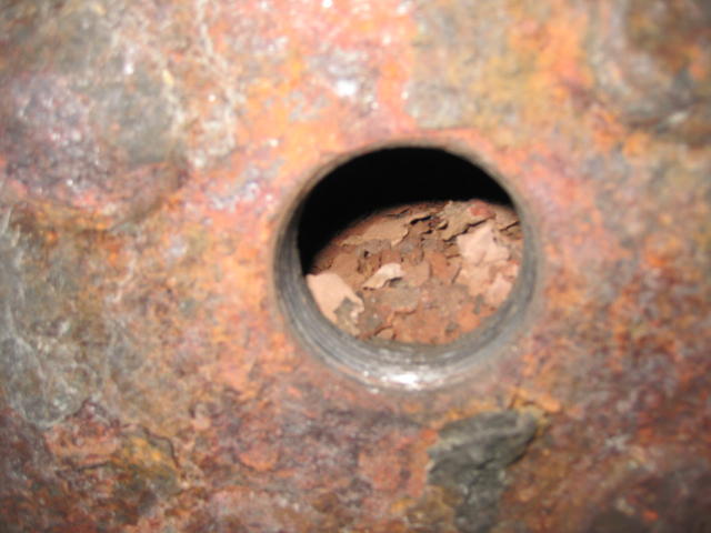

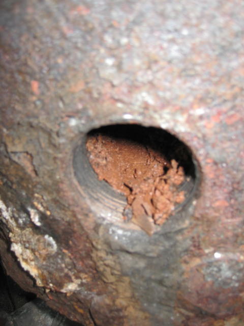

Des was pleased with the colour and consistency of this mud, which he says indicates that water treatment is being used correctly. If it were white and more solid he would be concerned.

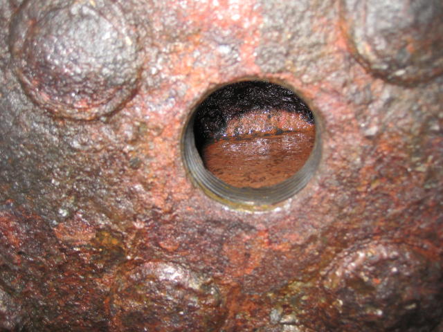

Clean
Clean

Somehow, it always amazes me how much scale, mud and other bits of dirt build up inside a boiler. Even more surprising, is after the boiler is washed out completely, how the dirt, mud and scale changes the colour of the ground below the washout plugs.
Shows how important it is to blow down the boiler regularly, while the loco in steam . . . . . . .
