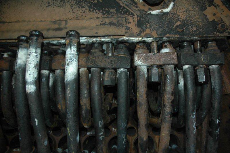

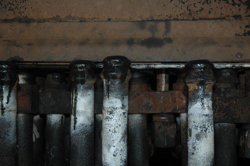

Close view of the last row of elements to be fitted and tightened up in the boiler of the 19D. The heads have been polished and smeared with a graphite and oil mix before fastening.
Capital Park class 19D recertification update 001.jpg (75.05 KiB) Viewed 7235 times
Closer view of the graphite and oil mixture smeared head.
Capital Park class 19D recertification update 003.jpg (63.73 KiB) Viewed 7235 times

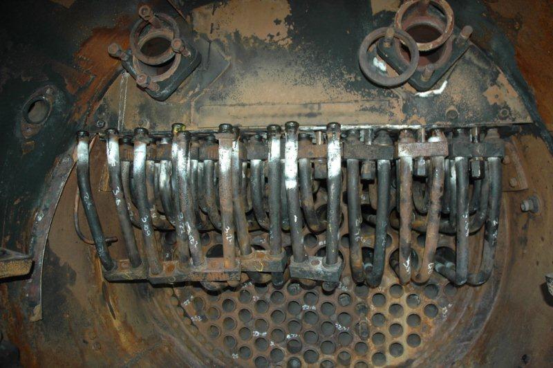

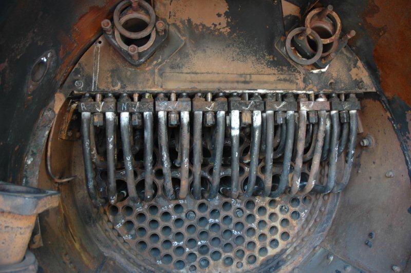

Just a few to tighten and the long work of removal, ultrasonic testing and hydraulic testing and refitting of the complete set of the elements has now been completed.
Capital Park class 19D recertification update 004.jpg (80.8 KiB) Viewed 7235 times

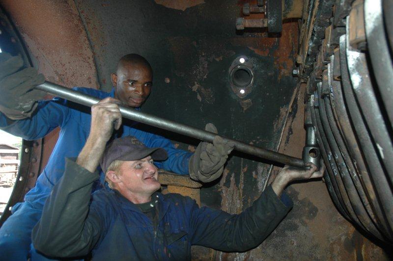

Raymond and Spikkels tighten up the last element bolt with the help of a long steel bar and of course the box spanner. All complete now.
Capital Park class 19D recertification update 013.jpg (66.43 KiB) Viewed 7235 times
Voila and the elements are all in and fastened. The main hydraulic test of the boiler will soon take place and then the steam test. Almost there till next time in 3 years!
Capital Park class 19D recertification update 015.jpg (79.31 KiB) Viewed 7235 times

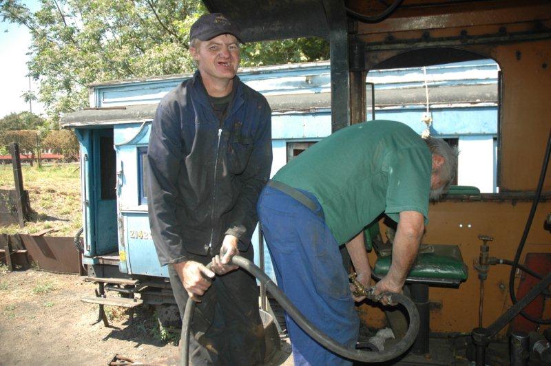

Spikkels and John at work at play and having some fun, so it seems. In reality they are getting the air driven tube rumbler ready to rumble the lime build up out the arch tubes.
Capital Park class 19D recertification update 017.jpg (84.65 KiB) Viewed 7235 times

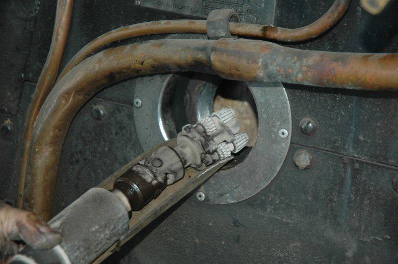

John Dadford guides the tube rumbler into the depths of the arch tube of the 19D.
Capital Park class 19D recertification update 021.jpg (60.11 KiB) Viewed 7235 times
Nasty Alien type teeth on the tube rumbler. This little feller gobbles his way into the arch tubes to destroy the lime build up that occurs in the tubes. Driven by compressed air, it will maneuver itself into the depths but still is guided on its way.
Capital Park class 19D recertification update 023.jpg (63.51 KiB) Viewed 7235 times

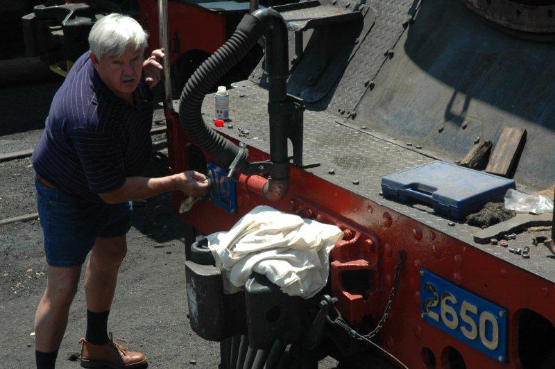

New member Thys fits the buffer plates on 19D 2650 that he had painted and polished up
Capital Park class 19D recertification update 025.jpg (73.38 KiB) Viewed 7235 times
