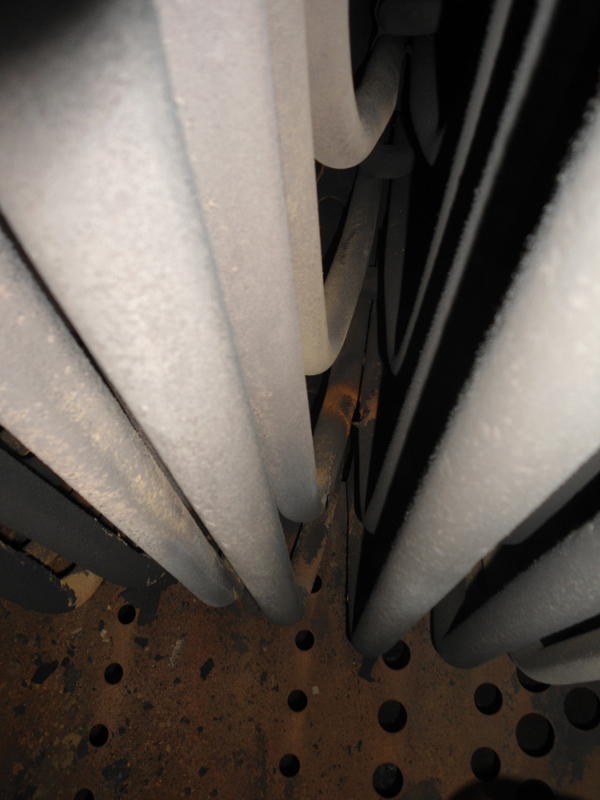

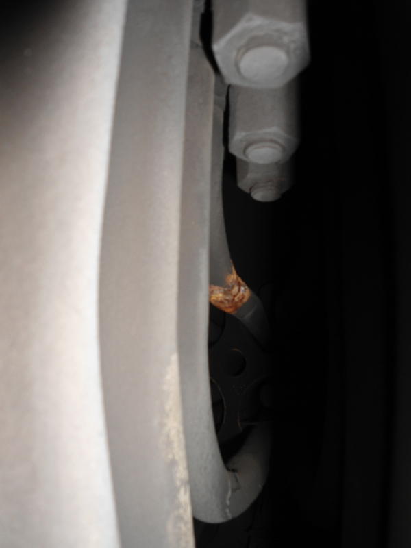

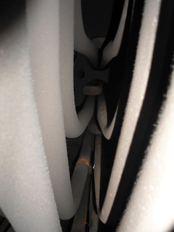

In the meantime we had another look in the smokebox and found some ominous discolourations and apparent distortion on three of the superheater elements.

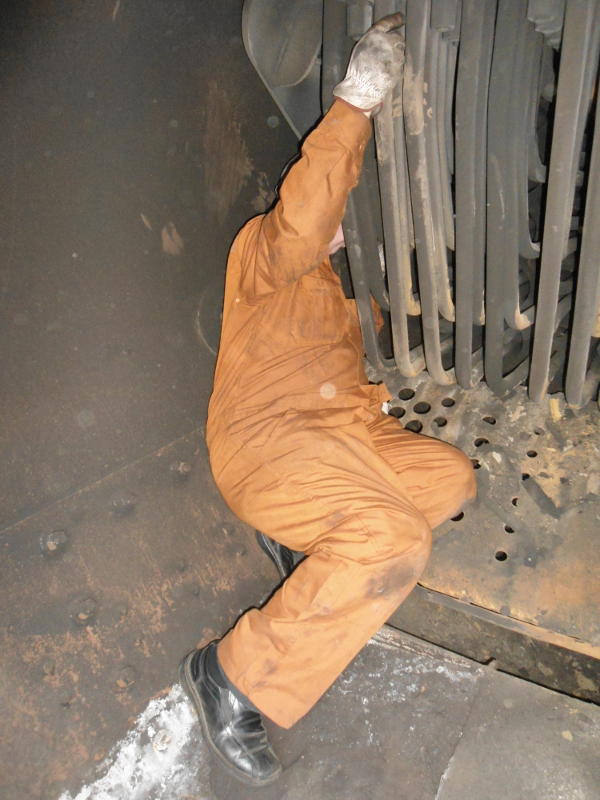

- Kevin examines the superheater elements
- 5918_DSC00583.JPG (76.51 KiB) Viewed 6621 times
- Discolouration and distortion on superheater element #1
- 5918_DSC00584.JPG (29.27 KiB) Viewed 6621 times
- #2
- 5918_DSC00585.JPG (42 KiB) Viewed 6621 times
- #3
- 5918_DSC00586.JPG (52.53 KiB) Viewed 6621 times
