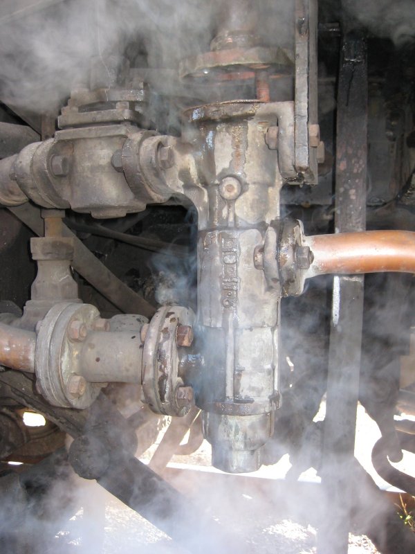

Minor repairs to the injector of 3664 took longer than expected. Initially it was leaking from where the steam inlet pipe joins the top of the injector. When that was repaired with a new gasket, a joint above the sellers valve also began to leak. Nothing is easy on a steam locomotive!
Photos by John Ashworth 28th June 2008

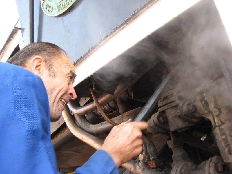

The injector, wreathed in steam, with the top already loosened
"I wonder what will happen if I poke a tommy bar in here?"

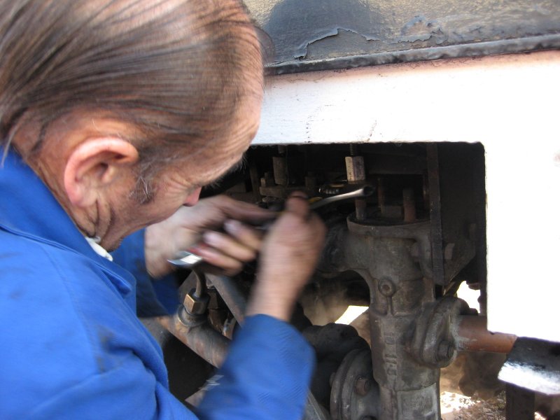

Two of the studs also needed tightening

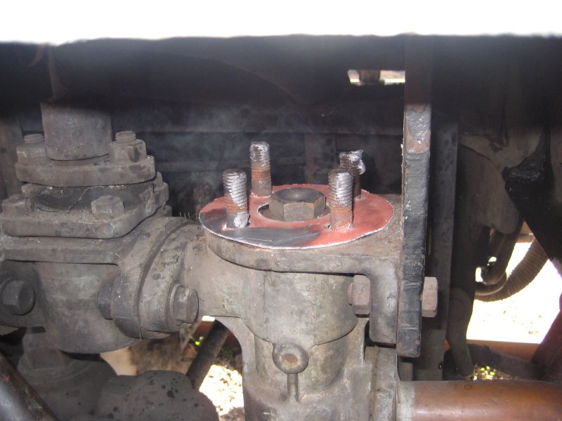

New gasket in place
New gasket in place
The flange is mated with the studs

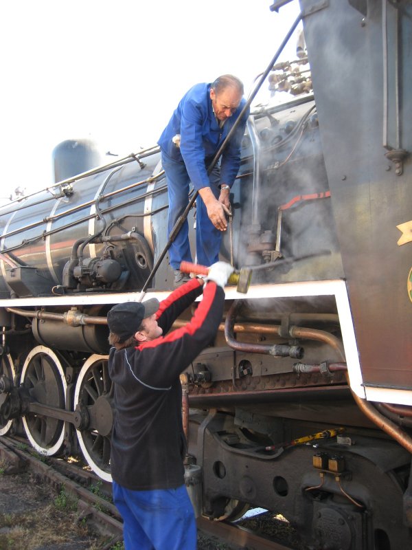

A railwayman's favourite tool: "Pass me the heavy hammer, Les!"

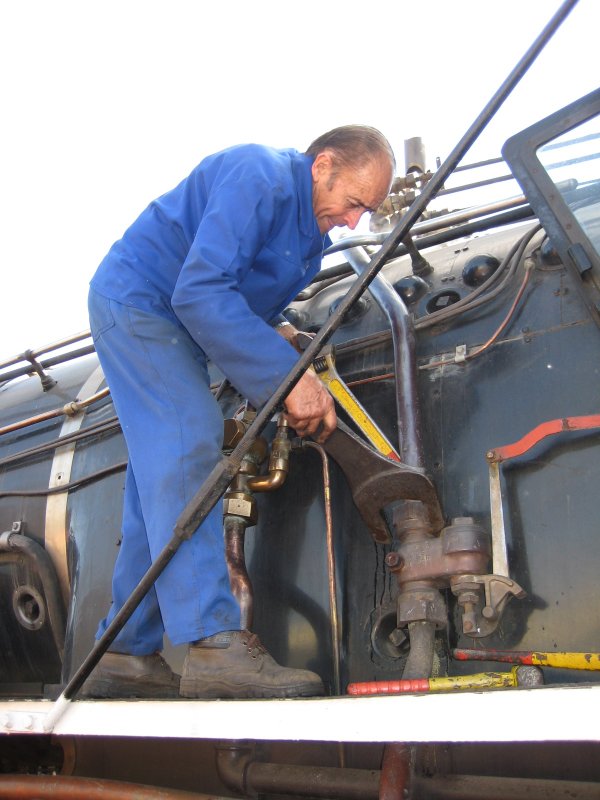

Tightening the joint above the sellers valve

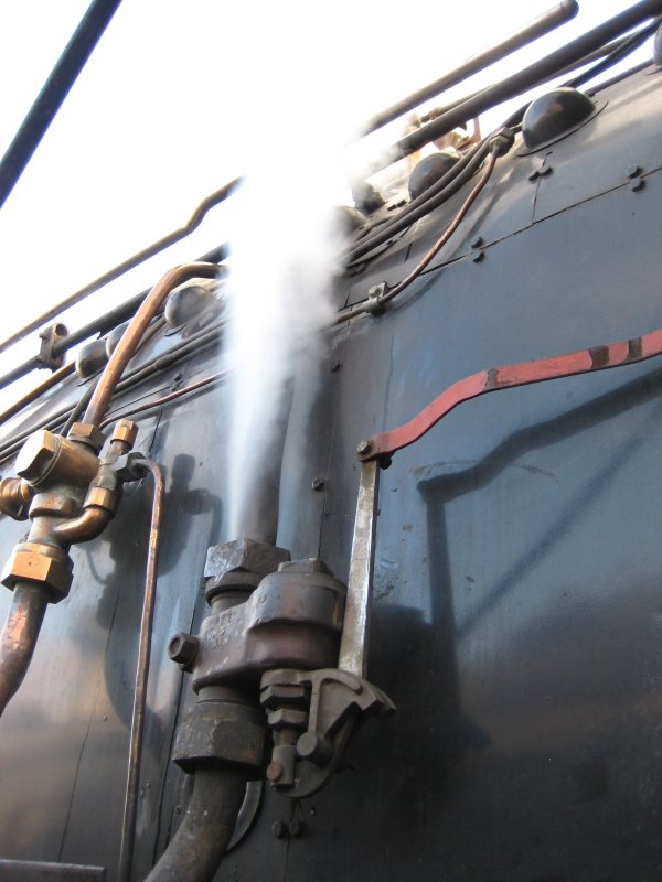

In the cool of the next morning steam can be seen very clearly blowing through the joint above the sellers valve.
Photo by John Ashworth 29th June 2008
Leaky!
Leaky!
