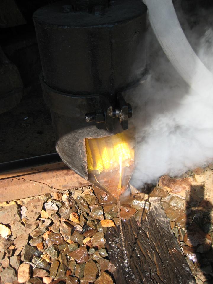

An old driver's trick - using the blowdown cock to cook mielies. These particular specimens belong to Marnie and are cooking nicely in 3117's blowdown cock at Cullinan on 29th March 2009.
Photo by John Ashworth

I think this topic should be entitled "Corn on the Cock... Blowdown cock"!

Ok.. now I know how to cook mielies with a steam engine.... but what is a blowdown cock really used for?

Other uses included filling the baffle box, as seen in the above picture, with ballast stones or empty cooldrink cans, and when approaching a road overbridge, one opened it up so that the missiles hit the ramps of the abutments and propell the missiles up and onto the bridge!!
